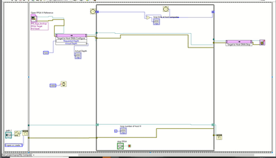

I want to use host VI to communicate with FPGA and read data from it. At first I used DMA FIFO to transport data, but later I found some sync problem with this FIFO so I deleted the FIFO.read section in Host VI. But even when the host VI is as simple as the following, it still fails to run FPGA VI. I think I configure it right, and in simulation mode (with simulated I/O), it can run FPGA VI and I can see changes in the waveform charts in the front panel of FPGA VI. But when I change execution mode to FPGA target, it fails anyway and I don't know why.

What is the error? How do you know it is failing to run the FPGA VI?

The icon on FPGA VI front panel doesn't change to running mode, and I cannot modify the parameter for FPGA VI through read/write control in Host VI.
But if I try clicking "run" on FPGA VI and then run the host VI, the latter can modify parameter for FPGA VI.
