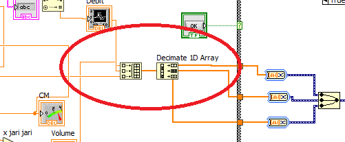

Thank you, you are very helpful, so what if I want to save the results of the sensor readings to Excel?
Message 4 of 11
(1,369 Views)

@Campuds wrote:
Can i use this format?
We cannot answer because a picture cannot tell us how you configured the express vi.
And as has been mentioned before, all your data gymnastics makes no sense at all.
