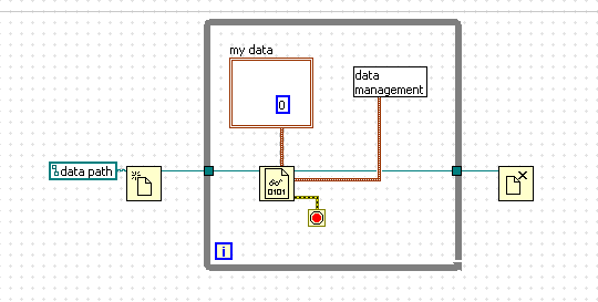

Your points 1-3 make very little sense without also showing some actual VIs.
Of course you cannot read the entire file into memory, but I assume you have decided on reasonable chunks. What is the datatype in memory? Remember that numeric arrays need contiguous memory and correct design is important so that consecutive reads re-use the same buffer. Also avaid extra data copies in memory (avoid locals and extra indicators and keep the front panel of subVIs closed. Avoid all code elements that force the front panel of subVIs to be in memory. Show us your code and provide more information.
What is the format of the file? (binary, formatted ASCII, datalog, etc.)
What is the datatype in memory? (string, DBL, U8, etc)

hi, thank you for aswer.
here you are my VIs.
Fast description:
Vi called: call by reference cycle, I use it to set the file size, location file, upper and lower limit (number of bytes) and indicators. This VI makes a call to subVI, but It is a call by reference.
VI called: call subVI, cycle; I do the same as described above, but It is a normal call to subVI.
VI called: subVI, is where I search my headers 129, 130, 131, 132. If the program find 129 then I have a data of time and for the rest of headers I have amplituds of some signal. For time (129) I need more cells to display: header, day, hour, second, etc. and for the rest (130, 131, 132) I just need two cells (header and amplitud).
there is another subVI but this only makes a decoding function and returns I32 data type (this is for cases: 130, 131, 132).
data type in the file is binary coded and the output will always be array of unsigned byte (U8).

hi Eric C.
Please check the VIs tha I send. In general: I open, read, show, close, repeat N times. So after each cycle I have an array of unsigned bytes and  Index (i of cycle), so I will join the sub arrays generated in each cycle.
If I undestand correctly, you say me that I should : open, read, show, repeat N times, close.
Is this correct?, what could be the difference?
thank you.
