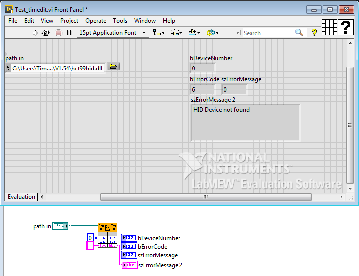

I'm confused though. The original Test.vi, and *.h show OpenUSBDevice as only having 3 parameters... but your latest picture now has 4. Where did the new function prototype and 4th parameter (OpenUSBDevice) come from?
For reference, i've attached my VI (saved to 2012, let me know if you need an older version) that works and a picture of the result.
Tim A.

Ohh well, when I said that the function has a return value, I didn't mean to add another parameter to the function with the same name as the function.
In the parameter list you see an entry return type. This should be changed from void to int32 instead. And not not as a pointer to value but simply as value.
And Timothy, you forgot to set a minimum size for the string parameter. As it is now you pass in a string constant with 0 bytes length. Since it is passed as C string pointer LabVIEW will create a memory buffer with one single NULL byte and pass it to the DLL function. That function writes whatever it wants to write into that buffer, overrunning its 1 character limit in every single case where it returns more than an empty string. Kabooom! although not necessarily everytime and often not directly at the execution of this function but only later on! But memory corruption of one way or the other happens at every execution of that function.
