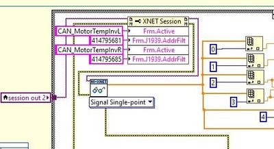

So, I've given this a try, but it is not working.  I have a 2 canbus setup...one is an ECU CAN and the other is electronic implement CAN.
The electronic implement is the one that has left and right side sharing same PGN with different source addresses.
For some reason when I insert the XNET Node, my engine speed on my ECU CAN no longer reads.  Other than my messy block diagram, can you see any errors I'm making in the picture below with how I'm using the node?
Message 5 of 16
(2,048 Views)
Those property nodes can only be used before XNET Start VI. If you try to set those properties in a loop, it might return an error, causing the remaining VI to stop working.

OK, I can move the XNET property node to outside of my case structure pretty easily.
However, I'm not using XNET Start...instead I've just been using XNET Create and XNET Read.
Can you explain the difference between Start and Read...in the context help the Read VI has data line out.
If I move the node outside my case structure and put an XNET Start before my XNET Read, should that work?

If you call XNET Read VI after XNET Create VI without calling XNET Start VI, the driver will call XNET Start VI automatically.
Using XNET Start VI will give you better control.
What matters in your case is that you should put the property node after XNET Create VI in the initialization subVI.

Thanks for your continued suggestions.
I moved the property node to be after my XNET Create as you suggested...and no longer within a case structure.
My other CAN channels from the ECU canbus now read properly.
However, the property node is not yielding a successful parse of my CAN channels sharing the same PGN but from different source addresses.
I've tried using both the arbitration id as well as the hex equivalent, and neither yield a change.
Is there anything else you can think of which I could check/change?

Are you setting the Frame or Signal name for the Frm.Active property node?
