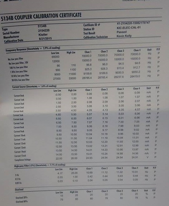

basically, I am interested for the accelerometer readings. The gain automatically changes on the signal conditioner once the user change the range (up tp +/- 10,000 g) and the sensitivity (0.000516 V/g) of the accelerometer. Does this <reading> of the gain which in this case is 1.97 needs to be taken into account?

So, please give some more information on your sensors.
accelerometer is ICP .... type?    Bandwith of signal conditioner? type?
loadcell? type? bandwidth? ... signal conditioning?
Your mass seems to have a resonace at ~4kHz and your loadcell at ~2kHz ?
If you put both on a shaker your simple peak approach migth work up to maybe 800Hz ,   personal guess ...

Accelerometer certificate
1 axis (vertical)
Single ended
Range = +/- 10,000 g
Sensitivity =0.532 mV/g = 0.000532 V/g
Resonant frequency = 100 kHz
Bias Voltage = 10,8 V
Signal Conditioner certificate
Load cell is just a full bridge load cell with 788 ohm input resistance
