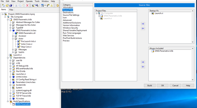

I could not see dependencies as member of Source files. Is there a way to add them here?
(1,421 Views)
Drag them from dependencies to your project.

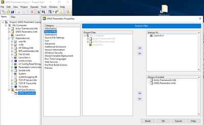

I dragged ActorFramework library to my project. Maked sure that it is always included.
After compilation it is behaving the same
(1,360 Views)
Are those other lvlibs also Actors? Like the File IO? If so, they all needs to be included.
