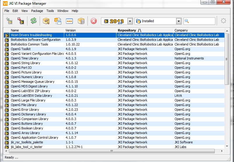

Hi all,
You all seem pretty knowledgeable about .NET assemblies, so I thought I would post an issue I have been having.
I have been trying to use VIPM to distribute drivers that rely on a .NET framework that is unsigned (i.e not in the global assembly cache).  My issue is that after the package is installed, none of the VIs will work because LabVIEW cannot locate the .net assembly.  However, if I launch labview by opening the library VIPM installed, all of the VIs will work, and LabVIEW is able to locate the the .Net framework and it appears in the main application instance.  I need to be able to use the installed vis all the time, not just when LabVIEW is launched in this particular way.  If anyone knows how this could be done it would be greatly appreciated.
Here is a link the all the files I used:
https://www.dropbox.com/sh/yjt2a0t8msxhgfn/AAC4VVW-hPawwXtGMrZ6wuIra?dl=0
Here are the steps I went through:
1) We put all the .NET dlls and the LabVIEW.exe.config file in the Labview directory.
2) We installed the package on our computer.
3)We closed everything and relaunched Labview from the start menu.  Then accessed the BioRobotics/Vicon palette.

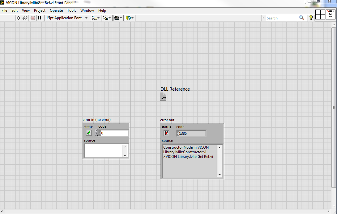

4)We placed the Get Ref subVI on the block diagram, opened it up, and ran it it.
5) We got the following error:
We also get a similar error for any VI that uses a method associated with the .NET dll.
6) However, if we again start with everything closed and launch Labview by clicking on the VICON.lvlib located in the vi.lib
7) Then repeat steps 3 and 4.  We do not get any errors in the VIs on the palette, and the .Net assembly loads fine.  We can even close the library and everything still works.  Somehow opening the library first makes LabVIEW know to load the ViconDataStreamSDK_DotNet assembly when using functions on the Vicon palette.
If anyone does attempt to build a new package, it is worth noting that I included the dlls in the source files, and in the same folder as the vipb:
Thanks!

@Cal27 wrote:
Hi all,
That's a pretty clear giveaway of the actual cause of this problem. When you launch LabVIEW normally the current directory for the process is set to the directory in which LabVIEW.exe is located. When you launch it by double clicking an assiciated file type, Windows Explorer (more precisely the Windows shell) will instantiate the process and set its current directory to the directory in which the file is located on which you clicked.
LabVIEW will request from Windows to load the direct DLLs with the explicit full path stored in the VI but any of these dlls depending on other dlls will only reference them by name. Now Windows when prompted to load a DLL by name only will look in certain locations for such dlls. The searched loacations are these:
1) if already loaded use this dll
2) if a full path is provided when requesting to load a dll, try to find it there (this is what LabVIEW requests for DLLs referenced from a VI)
3) the current directory for the process (set to the LabVIEW directory when LabVIEW is started normally but to the directory in which you clicked on a file type when it was started through a file association through the shell (Explorer)).
4) system directory
5) Windows directory
6) any directory listed in the PATH environment variable
This is for normal DLLs, the search order for .Net assemblies is by default much shorter and only contains 1), 2), 3) and the GAC. But the important point is step 3)!
One or more of the DLLs that are called by LabVIEW reference other DLLs in that directory and if even one single dependency can't be satisfied Windows will simply abort loading the initial DLL and return an error to LabVIEW that the DLL (assembly) could not be loaded.
