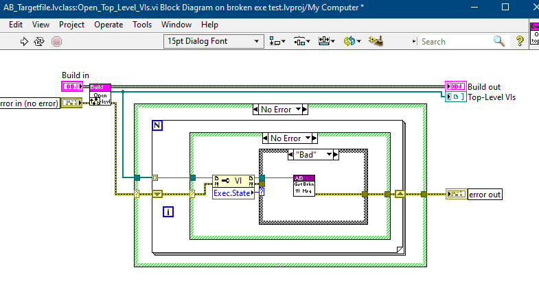

Something else you can try:
The build process is just a series of VIs that run.  Many are password-protected, but many are not.  If you look at the call chain of the code generating the 1003 error, you can see that "AB_Targetfile.lvclass:Open_Top_Level_VIs.vi" is 2nd from the top.  That VI is not password-protected and you can find it here:
<vi.lib>\AppBuilder\AB_Classes\TargetFile\Open_Top_Level_VIs.vi
This is its block diagram:
In theory, you should be able to find that VI on your PC and modify it to be something like this:
My example here does two extra things.
First I added an error handler inside the "Bad" frame.  The "Get broken VI message" subVI there is outputting a blank, so it's possible that the property node reading Exec.State is throwing an error, since "Bad" is the default output if the property node isn't working.
Second, whatever VI triggers the error is passed out and I set it to get all of its dependencies, and make a list of which ones report as bad (i.e. broken) as well.  That should hopefully not only list out the main VI, but all the subVIs that are broken and you can hopefully narrow it down to which sub-sub-subVI the actual problem is inside and do more intense debugging/analysis on that.
