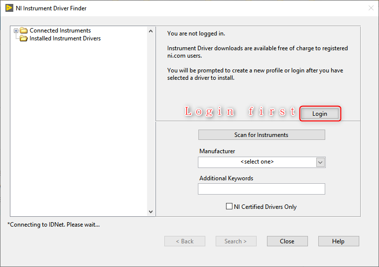

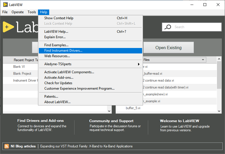

Hi cdis
I see you write a complicated Buffer reading vi. If your request is only reading buffer from 2182A, That I suggest you download Keithley offical 2182A driver of Labview than modified it may more efficiency and reliable for your work. If you also have question, you can still to ask me ^^
※How to download driver see below:
2019-08-25_15h33_00.png2019-08-25_15h33_32.png2019-08-25_15h35_21.png2019-08-25_15h36_05.png2019-08-25_15h37_06.png2019-08-25_15h38_33.png2019-08-25_15h41_53.png
(3,642 Views)
