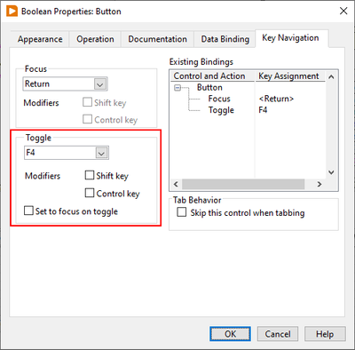

Attached is a simple vi "Key down Boolean Event.vi" (LV 21) that demo's the problem. I have mapped the F4 key to my boolean control to toggle it.
I would have expected the "Button":Key Down? event to fire when you press the F4 Key, however it never does.
I created a Pane Key Down Event and I can see the F4 key being pressed.
Mouse Down filter events work as expected...  so I am surprised key down events don't work.
With Mouse Down filter, the Pane is executed first, and then the control mouse down...
My expectation was that a key is pressed - LabVIEW fires the VI's Pane keydown? Filter, and then if the key is mapped to a control, it should fire the control's Keydown? filter event.
I discovered this as I was wondering why a key down filter event callback wasn't working. Mouse down callback works fine.
Is there a reason why this is not working? Any suggestions as it feels like a bug to me...

You get a key down event for a control if a key was pressed while that control has focus. Your control presumably doesn't have focus, so you don't get the event. Try tabbing to the control and see if it works then. You might think that you could use the panel's filter event and set the focus there, but that won't work.
The obvious answer is to use the value change event. Setting the key navigation to toggle the control should generate that event.

A new day and I remembered about Tabbing and enter or space on keyfocus which activates the boolean and runs the button's Key down? event. So at least it does fire if activated the right way.
What I was looking for was a filter event for the toggle key.. (I have set to F4).
I added the other filter events for the button, but only the panel gets the F4 key down event. Which seems to be a bit of a hole in the implementation.
Seems what I really need is a "Pre-Value Change Filter" event... that fires after mousedown / keydown / F4 toggle etc as I want to choose if the value change event is run or not.
I am starting to feel that the behavior is "as expected" however its not useful... where I was hung up yesterday was I linked my head F4 key to the button's key down filter event, when its not linked to that specific event.
So now I understand - I can disable the F4 key in code if present - and achieve what I want to achieve.
The other way would be to catch the value change event, decide to discard or not and if not, throw a user event to run the actual on value change code. But ideally wanted code that could be added easily semi-programmatically without rewriting the button value change event cases.
