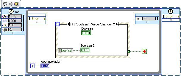

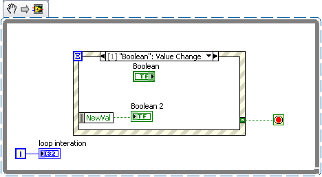

Has anyone else seen this discrepancy with the BF548?  I can write code that uses a single while loop and an event structure, and the code performs as expected.  When I add a second loop to the code (i.e. similar to the producer/consumer architecture), the event loop stops being event driven and just runs all the time.
I have attached the VI that is performing discrepantly  I have tried timed while loops, and normal while loops as well as shared variables and globals for stop communications between the two loops.

I apologize for the delay.  Here is a code snipet along with the compiled code.BF548 Event Snipet.png

Hi Joe,
I was able to reproduce the issue you have described. We're currently investigating it further.

Hey JoeC:
I have narrowed it down to the following:
1. Run on BF 548: With while loop: loop interation changes only when toggle
is pressed
2. Run on BF 548: With timed loop: loop interation continuously increases
I will escalate this to R&D
