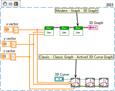

After doing some searching it looks like the first part might be pretty easy.  I am a little confused on how to get multiple channels.  I am looking at the help file for the 3D Line Plot Setup VI (LV 2015) and it looks like there is something called "plots in" with something called obj.  I guess I need a crash course in this now . . .I am going to keep hunting.
(4,359 Views)
I am officially stuck!  I have searched for a while but just can't seem to find an example that helps me understand how to get multiple plots onto a 3d Line graph.  Does anyone have any examples of how to use the "plots in" obj to make 3 line graphs that are essentially spaced out as shown in the first post?  this seems like it should be simple but I have not done much with objects before
Please help!Robot Very Happy
The create plot line.vi does not require a graph input, it will create an empty object. Simply add the VI 3 times with the x,y,z coordinate arrays.
Alternatively there is an ActiveX version in the Classic palette.
(4,246 Views)
Fantastic.  That worked like a champ.
