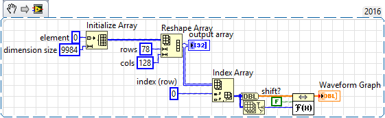

I have an array of 9984 of  I32  I want to be able to make 78  array's of 128  x I32 can some one please show me how to do this.

hi dpjones,
sounds like you want array reshaping.

Hi  jwscs
Thanks for your help  it worked fine I have one other question regarding the array reshaping after I have reshaped as per your vi what is the best way to select and show one of the rows 1 - 78 on an FFT .

@DPJones wrote:
Hi  jwscs
Best regards
David
Use the array properties to show the correct row, amount of elements, and which element will be the top left one.
