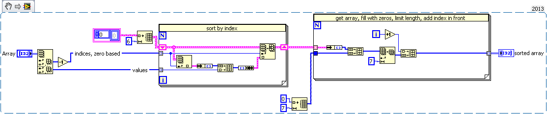

Hi mamunk,
to appreciate your first post here you may start like this:
It's probably not the "best" solution, but it should work according to your description…
For the next time you should note we will not do your homework.
Attach your VIs and ask for specific problems - not just generic "I need something, can you create this for me!"
