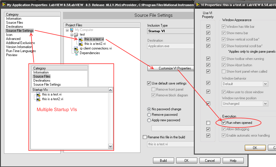

I wanted to update the community with the resolution to ScottyD's issue.
In summary, Scott has an application with multiple Startup (top-level) VIs.  Scott needed to build an executable that would contain all of these VIs and upon launching the executable, he needed to open, but not run those startup VIs.  While many can argue this startup sequence is not a good way of creating an application, the fact remains that this is a legacy application that Scott is upgrading from LabVIEW 7.x, and that is what is operators are used to seeing.  Therefore, Scott wanted to make the application as similarly behaved in LabVIEW 8.5 as the previous version of this tool as possible.
There are multiple ways of acheiving this behavior.  The first one that came to my mind when talking to Scott was to use a single top level VI that programatically using VI Server opened the front panels of the multiple startup VIs.  This would have required a code change for Scott, so we tried to avoid that solution.
The second method that Scott actually implemented to acheive his desired behavior was accomplished by digging a little deeper in the executable build specification.  Scott's main complaint was that even though he set in the VI properties that the VIs should not "run when opened", by default, the application builder always overwrites that setting in an executable to cause startup VIs to run immediately.  This is aligned with the explaination from GerdW, you never have to "start" Word.exe when you open a new document.  Most users expect an application to be running when they launch an executable.
While the application builder does override the "run when opened" setting, it is always possible to override the application builder, except in LabVIEW 8.2, where it requires a little creativity ;).
Below is a screenshot which outlines the procedure to have multiple startup VIs in a LabVIEW 8.5 executable that do not run when opened:
1. Specify multiple startup VIs on the Sources Files page of the application builder.
2. On the Source File Settings page, select each of the start up VIs one at a time and click Customize VI Properties...
3. Notice in the VI Properties dialog, the "Use VI Property" option is unchecked, and "Run when opened" is enabled and checked, thus causing this VI to run when the executable is opened.
4. Uncheck the box causing the "Run when opened".
5. Repeat steps 2-4 for each Startup VI.
6. Rebuild the executable, and now you have the desired (in this case) behavior.

Thanks again for the help. The key to this solution was to have BOTH boxes unchecked, if the USE VI SETTINGS box is checked and the VI properties is set to not run when opened, the 8.5 override still occurs.
Matt, Many thanks, my Technicians appreciated your efforts in resolving this issue.
