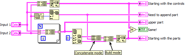

Not sure why the picture didn't come through inline with text.. so try 2. I need to append a 1d array to a 2d array, BUT the 1D array is coming out as a column, not a row, See pic below..

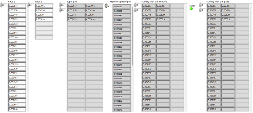

You have two 1D array inputs and what is labeled as "what I have" is actually "what you currently get". And since that "tail array" is the excess part of the longer 1D array, it seems silly to first clip of off, then insert it again.
My first code skips all that detour!
Now, if you actually start out with the short 2D array and a 1D array to be appended to column 1, that would be a different problem that is almost equally easy to solve. So what are the actual inputs (A: 2x 1D arrays or B: a 1D and a 2D array?). If case B, you should reformulate the problem so the example actually has these inputs.
To avoid confusions, your example should have exactly two array inputs and one output.
Here are some ideas.... (LabVIEW 2019. Note that I also removed the trailing \n from input 1)
There are many other ways to assemble the parts, of course. The best method depends on how general a solution you want. For example if these arrays are gigantic, and the short 2D array had many columns and you want to append to a specific column, other versions might be more suitable.
