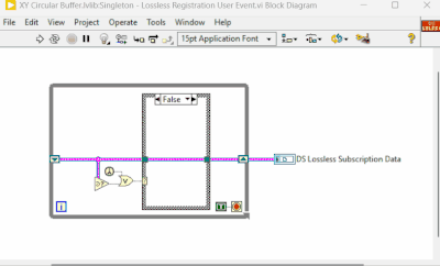

@drjdpowell wrote:
I'm fairly confident the different part of your codebase calls VIs asynchronously (by ACBR or "Run VI"), and one of those VIs is creating your DVR and then stopping, which invalidated the DVR it created and triggered your 1556 error.  Your bug, not NI's.
Hi Dr. Powell, If you look at the example code (gif) I posted you'll see we demonstrate the issue with really just 2 vi's and one is a simple subvi of the other. The vi on the left is directly called by the vi on the right (it's the first subvi on the error wire). There is no calling asynchronously happening here. My comment was simply to say that we tried to run our full application, got errors, stopped all running code.  These two vi's were shown as idle/not running.  We then ran the vi on the right, which calls the vi on the left.  The code is pretty simple, and you can see from the gif that it just creates a DVR ref, passes it out, the ref immediately goes into an IPE DVR read/write, which errors. Therefore, I'm not sure your comment still makes sense here, but please let me know if I'm overlooking an important detail.
Steven Dusing
CLA, CTA
Message 12 of 30
(3,806 Views)
Hmm, what does that "Keep here to persist in memory in Top-Level Callers" VI do?  That could execute before your IPE structure does.
Message 13 of 30
(3,786 Views)
That right, it could execute before or after... but it's unrelated code (just ensuring there's a queue that's made). I don't see how this could have any impact on the DVR.
Steven Dusing
CLA, CTA
Message 14 of 30
(3,767 Views)
You've convinced me this is a likely bug in LabVIEW, since I can't see how the DVR could be invalidated, given no other code is running.  It appears something has gone wrong with the DVR reference.

Accepted by topic author sdusing
This problem is likely related to Bug 2411021, which requires a recompile of the code to fix the issue. Note that this should have happened transparently, but could potentially be an issue if some of the code (but not all) has been compiled in LV 2023 Q3.
@sdusing, can you mass compile your entire codebase and confirm that that the issue no longer occurs?
