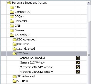

Any LabView Example code of using NI USB-8451 to write/read data from i2c device?
Looking for a quick Top level example Labview Code to be able to read/write to i2c SEEPROM devices using an NI USB-8451 as a controller.

Hello abon27,
There are some great examples in the Example Finder (LabVIEW Help Menu»Find Examples).  Select Hardware Input and Output, then I2C and SPI (see the picture below).
If you need futher help getting started programming, the NI 845x Software Users Manual has some very good information.  In particular for your needs, take a look at Chapter 5 in that manual, it details the LabVIEW API implementation of I2C.
Let me know if you have any other questions,
Meghan R

Hi, smercurio - Thanks, i can find the examples after i installed the driver.
