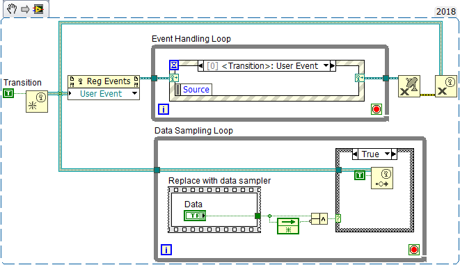

I am really stuck with something that I though would be very straightforward.  I want to initiate a dynamic event every time a Boolean value is true.  This is easy enough if I create a front panel control, which I can use to generate a dynamic user event that executes some method.  However, if I have some signal that is being read which has values of 0 or 1 (e.g. a digital waveform) and I want to use that signal to trigger the event, it does not work as expected.  I tried using a case structure within the event, but that simply does not work.  Imagine my program is sampling a digital waveform, but doing so at a very high rate (much faster than the changes between low and high), then what I'm finding is that the event is triggered at the rate determined by the sampling and not by the actual change in values between high and low (like a normal hardware trigger would do).  I tried all sorts of things; for instance, I can write the Boolean values to a reference and use the property node with value(signaling) to try and trigger the event that way.  I tried using case structures so that the event is generated only when the Boolean is equal to true.  No matter what I do, the event still triggers at the sampling rate and not at the rate at which values are changing.  Say I read 0 0 0 1 1 1 0 0 0 1 1 1 0 0 0…  then I can’t help but trigger the event each time a value is read instead of each time it changes from 0 to 1 or vice versa.  Any ideas?

You need to test for a change of state of the signal, and only then generate the event.  Like this:

You can create a dynamic event (also called user event), that is only generated when the desired transition is found. See below for a couple different bits of transition logic.
Using comparison functions is simpler and makes the code easier to read and understand. 😄
(of course the global init value depends on the situation, so modify as needed)

I tend to make heavy use of the "Compound Arithmetic" function, both because it expands to multiple inputs and also because the input and output terminals can be inverted individually.   I also tend to force my "transition" detection to return a False on the first iteration.  So here's what I'd be inclined to do:

I usually wire the Init input from the Feedback node to the input. Seems to have the same effect but avoids to have to think about the value of the boolean constant depending on the slope you want to detect.

Perfect!  Problem solved.  Thank you to everyone.
