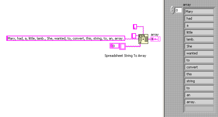

If you want to remove the commas, try the example below using the Search & Replace string function.
RayR

Hi Wonseok Yoon,
The image below is the example.  You do not need a loop to convert the text to an array.  You can replace the While Loop with a "Spreadsheer String To Array" vi.   It is located in the strings functions.
You simply wire the string from the HP34970 READ to the spreadsheet string input, place a blank string at format string, place a comma for the delimiter (on top), and very importantly, wire a sting array constant to the array type (bottom).
RayR
