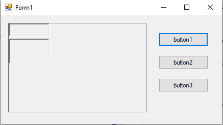

I wrote a simple .NET class library in visual studio using the .NET Framework 4.6.2 and targeting the x86 platform.  The constructor for the library requires a reference to a .NET panel control and adds a .NET SplitContainer control to that panel.  I tested the library by adding it as a reference to a simple WinForms project in visual studio.  You can see the SplitContainer in the upper left hand corner of the panel on the WinForm below.

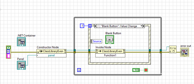

Eventually I added a .NET panel object  to the .NET container on the front panels and then from the block diagram tried using the .NET "Constructor Node" function from the .NET subpalette of the Connectivity pallet.  The .NET library loaded fine and the constructor argument and other public functions appeared as expected in the block diagram.

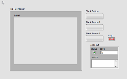

The only problem is that the SplitContainer never appeared in the Pallet of the front panel after running the VI.
I tried calling the .NET Panel methods Show(), Refresh() and Invalidate() using the functions inside my library but the SplitContainer never appeared.  The .NET Constructor Node would not accept a reference to the panel or a local variable representing the panel.  It seems I'm very close but no cigar.   Any thoughts?

I made it work by skipping the panel and adding the split container directly to the .NET container.  I seem to be able to call public .NET methods and properties from LabVIEW without any trouble (click on the first 2 buttons to see this work) as long as the control itself was originally created (constructed) in LabVIEW.  So the only limitation I'm left with is not being able to use the .NET constructors.  Maybe some magic can be found using variants or anonymous types.  Otherwise, I'll have to wire objects created in LabVIEW to the Constructor Node and then I can do what I want with them using the invoke node and property node functions in the .NET subpanel of the Connectivity Pallet in LabVIEW.  If LabVIEW can't work with .NET constructors, that might explain why they created the "Constructor Node" function.
(4,195 Views)
When embedding .Net controls in a .Net container in LabVIEW you do not use a constructor explicitly. Instead you assign a specific .Net class implementation to the .Net container and LabVIEW then calls the constructor automatically. Basically the .Net container is itself the object constructor. There is one specific difference though. The .Net container gets initialized at initialization time of the VI (usually at load time when you run your program), which means that the .Net class gets loaded then, as there is no explicit constructor that gets executed somewhere at runtime.
Your attempt to assign a LabVIEW object to a panel property of your .Net component could never work. A LabVIEW object is NOT a .Net class but something totally specific to LabVIEW. The .Net container does internally use a Windows window handle that is passed to the .Net control at initialization time to tell it where it is allowed to draw itself into but that is a private implementation detail of the .Net container.

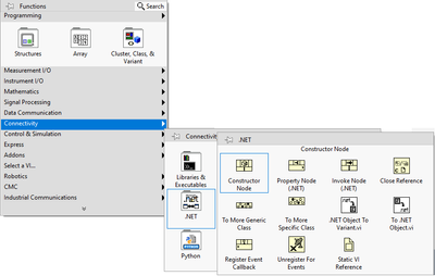

But there remains some confusion perhaps due to semantics.  It seems the phrase ".NET Contructor" is sometimes used in reference to the "Constructor Node" function of the .NET subpallet under the Connectivity pallet in LabVIEW shown below.

Not really. The constructor of a .Net class is called by LabVIEW through the Constructor node when you "construct" an object to be used as class library. The runtime execution of the LabVIEW constructor node is pretty much the same as the .Net statement (plus some LabVIEW related management):
objectRef = new MyClass();
By far most of the .Net classes used in LabVIEW programs are simply libraries that implement one or more classes with methods and properties and no user interface facing part of any sort.
In order for a .Net object class to be insertable in the LabVIEW .Net container, it needs to implement the System.Windows.Forms.Control interface or some derived class of this.
LabVIEW will initialize the object implicitly when it loads the VI containing a .Net container with an assigned .Net Control class. It will also call the Control objects constructor at that time and you do not need (and shouldn't try) to call the constructor yourself by using the Constructor Node. It would simply load another instance of that class but without any connection to a LabVIEW container in which it could display itself. The Control class is already constructed by the time the VI containing that container has finished loading into memory.
