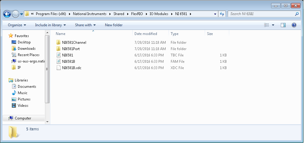

I am having this same issue. Every other adapter module has a .tbc file exept the one I need (6581B). Did you just install FlexRIO on an entirely different computer then transfer it?

Hey Scott,
What version of LV and FlexRIO do you currently have installed? and to confirm, the NI 6581B is not showing up in the list when you go to add it? What FPGA module are you currently using?
The NI 6581B should have a .fam file (same information as .tbc file), which would contain the necessary info for it to appear in the list. Since LV 2012, we've been moving towards using the .fam file extension instead of .tbc. Below is a screenshot from the FlexRIO MDK manual that should provide a bit more detail.
If you browse to the following location you should see the following files, do you see something different?
C:\Program Files (x86)\National Instruments\Shared\FlexRIO\IO Modules\NI 6581

Hi Rob,
Correct, initially I could not see 6581B in the list and there were no files at all under C:\Program Files (x86)\National Instruments\Shared\FlexRIO\IO Modules\NI 6581, except for two folders NI6581Channel and NI6581Port.
I have LabVIEW 2014 + NI FlexRIO 14.0.0 but I think the issue was with the version of NI FlexRIO™ Adapter Module Support that I had installed (NI FAM Support 14.1.0). What I did to resolve the issue was install a later version FAM Support 14.3.0. Once I installed version 14.3.0 I could see it in the list and add it and the .tbc/.fam/.xdc files were also visible in windows explorer at C:\Program Files (x86)\National Instruments\Shared\FlexRIO\IO Modules\NI 6581 (in addition to the two folders I mentioned).
