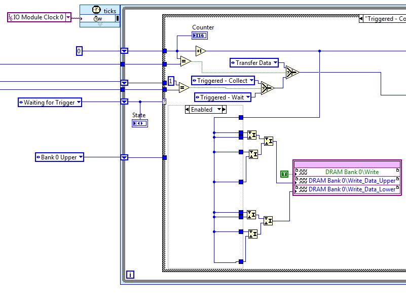

I now understand what you are talking about. I think it would be worth disabling the actual inputs (shown in screenshot by using a diagram disable) and tieing it to your counter line so we can verify if the data is coming in correctly or if it may be the actual hardware. I have been looking through your code and everything seems to be coded properly. It is very peculiar that you can read data for the first four triggers but the fifth behaves this way. This hardware is fairly hard to come by here and I am trying to wrangle some up to try and reproduce but I think sending counter data in will definitely help us monitor what the FPGA is doing. It would also be helpful to put indicators before and after you write and read from DRAM to make sure it is the same data. The DRAM FIFO is a destroy type of read so it should be popping that off of the FIFO and not filling it up over time.

tannerite, I made the modified the code to disable the actual inputs and just use the counter into the DRAM as you suggested in your figure above. I now always receive a single value as the output, which is the same for every channel. I added a latching time out indicator for the DMA FIFO. This never latches. I added an indicator showing the last data point read into the DRAM and the last data point read from the DRAM into the DMA FIFO. These were not the same. I added a latching 'Full' indicator for both Bank 0 and 1 DRAM banks. Both of these do latch. I am confused by this for a couple of reasons. First, the DRAM FIFO should be cleared when the card is reset at the beginning of the code running on the host machine. The code uses a counter to ensure that only 5000 points (or whatever the user specifies) gets written to the DRAM. The PXIe-7962R has 512 MB of onboard RAM. I don't see how I could fill this with 20,000 64 bit integers (5000 x 4). Second, looking at the help file for the FIFO - 128 Bit Memory Interface, the second to last paragraph states, "The FIFO - 129 Bit Memory Interface is designed to simultaneously read and write data at speeds up to 40 MHz. It is possible to run the interface up to 200 MHz. However, at speeds greater than 40 Mhz, the 'Full' and 'Data_Available' signals may temporarily become TRUE and FALSE, respectively." Since I am using the IO Module Clock (50 MHz), it seems like the 'Full' indicator may be unreliable. I repeated this with the DRAM clock and loop clock set as the 40 MHz clock and the same thing occurred. So somehow, the DRAM is filling up. I'm at a bit of a loss for how this is happening though.

I have added code to clear the DRAM FIFO. I had to add it to the state "Waiting for Trigger" because I use the IO Module Clock for the DRAM. When I tried to exit the loop as indicated in your screenshot, I would get an error message stating that I cannot exit a loop that uses an external clock. I think my solution should do the same thing that yours does though. I also added an indicator to show when the DRAM banks were empty so I would know the system was ready to trigger. I did not want this one to latch.
When I ran the code, the indicator would rarely be lit, meaning it would occasionally light up, but only for short periods of time (<1 s). I believe this means that either there is a problem with the Data_Available or something else is writing to the DRAM FIFO. I have attached an updated version of the code below.
