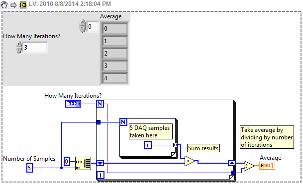

If I understand you correcty, you could use a shift register to store your final array.  Then just sum each time you calculate an array.  Lastly take the average by dividing by the size (user specified for the for loop).
This is a rough example of what I mean:

I like the creative solution you have provided however, I am trying to keep the average at each element so that I can graph the average at each point. Therefore, I need the average to be a 1D array of the same initial length, not a scalar.
I am trying to avoid using shift registers.
1. Do you mean you want the average after each iteration as well?  This can be done pretty easily by moving the division inside my loop.  Perhaps I am misunderstanding you though.
2. Why avoid shift registers?  They are amazing and effective.  They are an essential LabVIEW tool imo 😛  Plus they work wonderfully for your current problem.
If someone helped you out, please select their post as the solution and/or give them Kudos!

You absolutely should be using shift registers here.  How else is iteration 2 going to know what values existed during iteration 1????
If you add two arrays (just the basic math operation) they add by index (index 2 + index 2) then just divide by the number of loops after the for loop has finished.
If you want to calculate the moving average (update average during the loops) you'll need to employ a moving average algorithm... NOTE that simply dividing by the iteration number here will give you the WRONG RESULTS.
Good catch!  I stand corrected on that part 😛  Its been a while since I worried about means.

I am using Labview 2011
I have tried using shift registers and because I exit the loop, a feedback node appears and it seems to be nullifying the array instead of storing the data. Perhaps I just don't understand how to properlyy use a feedback node.
Thank you for all the help so far. I've really been pulling my hair out.
