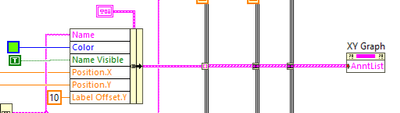

I am trying to add a text label (E0, E1, E2 etc.) for every data point in XY graph. I am using Graph Annotation but it does not plot Text Name on graph for every data point but the last one. Any suggestions will be greatly appreciated.

Your annotation array never has more than one datapoint because your use of the inplace element structure is completely pointless
Having a 9 second wait in the innermost of three stacked FOR loops means that the program will take forever until we see something. Do you want the annotations to update with each new element or do you want to just show all annotations at the end. In a well designed state machine, a single loop is typically sufficient.
To show them at the end, here's all you need to do.
Else you would need to append to the annotation array, kept in a shift register.
