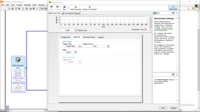

Hello! I'm very new to labVIEW (just started working with it yesterday) and my goal is to acquire data from de DAQ board every time it is externally triggered. I'll have a device connected to my PF10 chn that will send triggers every 1sec, and I need to record data every time it does. What I was able to do so far was wait for my trigger to be first read and only then start to acquire the data, but once the first trigger is in, even if I stop triggering the DAQ it keeps acquiring data. I want it to acquire data only every time it is triggered. Is there a way to do this using labVIEW?

Hi Teresa,
the USB6008 only allows for start triggers…
(You could start your acquisition upon trigger signal, stop the task after 0.1s, and restart the task to wait for the next trigger. This might work when the trigger signal will only occur every 1s or so…)

Yes, you're right, but I only have this, and I'm using arduino to trigger the DAQ board right now, but when I disconnect arduino it keeps acquiring data, and I only want it to acquire data while it's being triggered.

Hi Teresa,
Bob asked you for code and all we got are two images, showing parts of the code…
Please attach code (VIs!), when you are asked for code!
Again I repeat: the USB6008 only supports a start trigger! After being started it will continue to acquire samples - until you stop the task. Did I mention that already in message #2?
It is even visible in your image: you configured a "start trigger" in the DAQAssistent ExpressVI!
