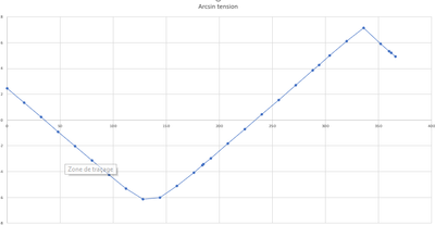

Hi Jay,
The grey data points is the output of my demodulator which I don't understand how to copy the behaviour,
Moreover, if I arcsin those points do I have to divide all the values to set them under 1, then arcsin, and then re multiply by the scale factor ?
With this method I have this :
The shape looks good but I don't know if the method is correct,
Respectfully,

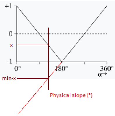

Henrik,
Thank you for helping me,
The characteristics of the RVDT is as it follows, it's made by our customer :
To summarize:
- I need to measure the excitation and the RVDT output at the same time (one AI each), i'll do it in the FPGA
- I convert it into signal labview data
- Thanks to Extract tone information.vi, I get amplitude and phase
- With the ratio I know the level of what I need to convert into degrees (°) and with the phase difference if i'm on the left or on the right of the V-slope, so I know if I need to take the conversion as it is or conversion = ( minimum of the V-slope - conversion)
Am I correct ?
Question: the RVDT output is VS1-VS2 or the ouput of the demodulator (cf. grey curve in my last message) ?
Respectfully
Message 9 of 26
(3,019 Views)
@Ayous wrote:
Hi Jay,
Respectfully,
Well without knowing anything about the modules internal workings, if you can linearize the output over the range of interest, you can calibrate the output to give you the measurement you are looking for. If you have a linear output for the valid range of the form Y=mX+b where X is the input from the sensor (in this case linearized with the arcsin) and Y is the desired output. Use m and b to map X to Y. Rotate it to the maximum position and use a reference sensor to get your initial x1 and y1 point then rotate it to the other maximum valid position to get x2 y2 draw a line through those two points and you have your linear calibration line.
