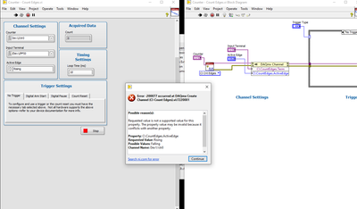

Would you please help me to know about my problem on attached VI
I programed a digital counter on my USB6009 with Daq assist and it was ok but with the same hardware it is not ok for the API program.
What is my fault?

Hi sml,
this is how I create a counter task on a simple USB6008:
"CI - Flankenzählung" is German for "CI - counting edges", with looking for falling edges ("Fallend").
I use the physical channel "ctr0"…

Hi GerdW
Thank you for your time, But I didn't quit catch. I used "CI counter edge" but there is still a problem.
Would you please see my attached VI and tell me where is the problem?

Hi sml,
Right now I cannot open your VI, see my signature line. Mind to convert to LV2017?
Which problem do oyu encounter? Any error messages?
(Delete the DAQAssistent before trying to access the very same channel using the DAQmx API!)

please try ne attached file (LV2017).
I have counter with Daq assist but with the same hardware and configuration I don't have any counter by API programming method. There is no error or massage.
I am new in Labview and I try to learn.
Thank you for your help

Hi Sml,
You cannot use the very same hardware resource in two DAQmx tasks!
Delete the DAQAssistent!
(Right now you try to access "ctr0" with the DAQmx functions and with your DAQAssistent. This will not work…)

Hi GerdW
Yes, I deleted the Daq assist already, but it still not working.
Yes, I passed one of NI training course.
With NI examples I have an error and with changing active change, the error is still existing.

Hi Basjong,
Why don't you read the error message? It clearly tells what is wrong in your code…
You are using very simple, old, and cheap DAQ hardware with very limited capabilities. So it only allows to count for falling edges -  as mentioned in the error message!

Dear GerdW
Thank you for your reply
in comparison with first reply, I just needed to define edge direction.
Thank you dear Gerdw  🌷
