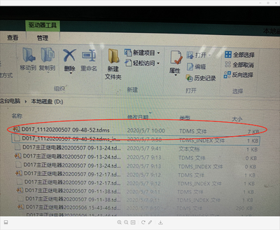

I'm trying to use TDMS Flush method to write data into a HDD file periodically, in order to avoid data lost when system crashed or power failue occurs.
I forced system reset when the test VI running, then I get a TDMS file with several KB size, but I can't open that TDMS file. the following pics show the detail. 
78ef1a96ab53660b293c7694224674b.pngthe tdms file size is 7KB, seems the data are stored.

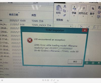

2089bc3b741aa0753714ae617bde944.pngsome error windows popup when I try to open the tdms.

Seems that the file got corrupted because it was not closed properly. Do you receive an error if you read the TDMS file using TDMS Read function?
