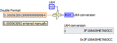

Your value is actually 0.0000630919967079535127
Once you show more digits on your input and enter the correct value, the results agree.
(Note that the closest you can enter is 0.0000630919999999999984).

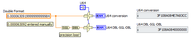

That series of zeroes at your end tells me that your DBL was probably derived from a lower precision representation number. Where does it come from?

Change the display format of your constant from 6 significant digits to something higher like 18 digits of precision.
You'll see your constant is actually something else and the rounding to 6 sig. figs. made it look like 0.000063092
Yes, as I suspected, your number is actually derived from a SGL, and converting it to DBL does not really give you more significant bits. Here's the proof!
Your original incorrect result is at the bottom.
(3,828 Views)
Interesting.  I didnt realize that If I originally typed the value in a SGL, and then converted the numeric constant to a double, it would still retain the 0 afterwards.
I am trying to program the value 6.30920E-05 into a device.   To write the number to the device, it needs to be converted to HEX.
Got it now, after I deleted the NC and started with a double first, before I entered the value manually.
