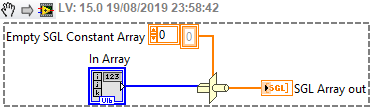

Something like this?
Convert U16 array to SGL array. Remove "Swap Words" or insert "Swap Bytes" after "Swap Words" if needed.
VI attached.
If you do not need the "Swap Words" function you can remove the cast to U32 array.
Since i have LabVIEW 2012 i could not see whats in your example.

Sandy,
     Did you realize you combined U1 and U2, with U2 being put in the High byte and U1 in the Low byte, then swapped them, so that U1 was High, and U2 Low, thereby "undoing" the order you used to combine them?  You can, of course, fix this by adding another "Swap Words" (or adding another three "Swap Words"), or maybe doing something else (I'm not telling!) and getting rid of the Swap Words.
     Also look at RolfO's suggestion of another way to combine 2 U16s into a U32 ...  Here the Swap Words may well be necessary, depending on the order your device presents the pieces.
Message 8 of 24
(4,844 Views)
Assuming that In1 is the first value in the array you create, and In2 is the second (and then you have 3&4, 5&6, on to 49&50 or 99&100) then you can use the solution described by RolfO, but not exactly as shown in the image.
Since you're swapping the low and high, and wiring them opposite to one another, you can simply wire them in order and remove the swap.
That leaves you with the following:
