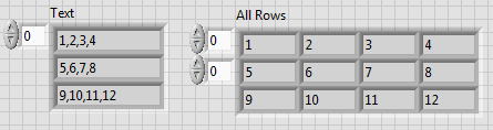

Oh, well.  I've just written a DEMO CSV File routine that (a) creates a small array of integers (1-12, as a 3-row, 4-column array), writes a CSV file, reads the CSV file as text (showing an array of 3 lines, the first being "1,2,3,4"), reads it as a delimited spreadsheet to get back a 2D array, and shows that if opened by Excel, is an Excel 3x4 array.  I'm going to post it, anyway, in case others are "challenged" by this issue.
You'll note that I also include the "mysterious symbol", a pink right-pointing arrow, that you didn't understand.  If you look on the String Palette, you'll see it is a Tab Constant.
Here are the Front Panel, Block Diagram, and Excel image.  The VI is attached in LabVIEW 2015.

Wow! Now that is where delimiter simbol is set! Who would ever knew!
So, what do we have here?
.csv is well opened in Excel with proper delimiter symbol, that is set in System preferences.
.txt file is well opened in Excel with default 'tab' delimiter.
Though, as I understand for now, there is no way we can change the format that is used for .xml file. Thus we always have the left side of picture instead of right.
