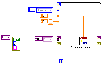

Some wishful thinking: Is there a way to pass an array for each parameter of the Create Virtual Channel VI ? So, if I am acquiring three channels (dev3/a11:3), I input an array with three elements for each parameter and the VI auto indexes my array to the channel array index...
For my two channel function using two Create Channel VIs is OK. But what if someone is working with 24 or 180 channels and each of them has subtle differences in ranges?

Hi Gurdas,
of course you can use it in a loop. See the attached picture.
