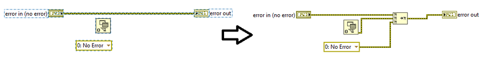

Makes error wire handling a bit easier.
1) Select sources and one destination. It will create the merge error and wire up the rest of the selected sources.
Note: It will select the right-most non-source and non-wired terminal.
2) Select an existing wire and new sources. It will insert a merge error at your right-click location then wire the rest of the selected sources.
3) Select a merge error and new sources. It will expand the merge error and wire all new sources in.
These were listed in reverse priority. It will check for an error node selection first, then an error wire selection, then just default to finding the destination and creating it's own.
If you hold CTRL before right clicking and while clicking Merge Errors, the existing merge error and existing wire will insert the error in the bottom and top of the merge error node depending on if it is above or below on the diagram.
Attachment is saved in LabVIEW 2016. However, I am not sure when the "Is Error Cluster.vi" was introduced, so it may not work for some versions.
For install instructions, go here.
Edit 8/2/21: Fixed the problem of the rightmost node having a source. Added CTRL functionality for sorting error priority. Also changed the plugin affected objects from GObjects to a collection of slightly more specific GObjects

So I was thinking about error priority for this plugin. I had a few questions for the people using this
  • For the existing wire case, I would assume a default of having the existing wire being higher priority is good?
  • For an existing merge error node, would people like the ability to hold a key and have it insert at the top? (Not sure if that's possible)
  • For the existing merge error case, maybe sources above the merge are inserted above instead of the above option. This just relies on you sorting priority vertically first.
