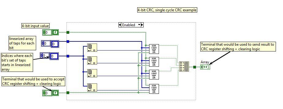

Do you have a suggestion on how to handle loop-iterator terminal items?  For instance, suppose I have an array acting as  ROM - linearized from a 2D array to a 1-D array because labview FPGA doesn't like 2D array types. In VHDL, I  would typically use a generate statement along with a "stride" to parse that array into pieces to send to the generated logic.  Here's an example of a 4-bit unrolled parallel CRC function.
Loop before unrolling:
Loop after unrolling:
Notice that this would not give equivalent behavior since the for-loop iteration terminal has been removed, but not replaced with similar functionality.  Putting a shift register + adder into the design creates a VERY long adder-chain for high iteration counts.  For instance, extending this 4-bit CRC into a 32-bit CRC is unlikely to make timing.  So Two alternate ways to get this functionally equivalent to the original loop would be as follows:

Do you see any better (automated or otherwise) mechanisms for handling the notion of "stride" in a linearized array in LabVIEW FPGA?  Using a pre-computed set of indices into the linearized array gets around having to do anything other than increment - but I still need to index into each element of that indices array.
Thanks for any suggestions you might have.  Unfortunately I found this tool this morning, rather than last night when I put hours into manually parallelizing loops for unwieldly amounts of replication after finding simulatable models didn't allow synthesis (though equivalent vhdl constructs would be synthesizable).
