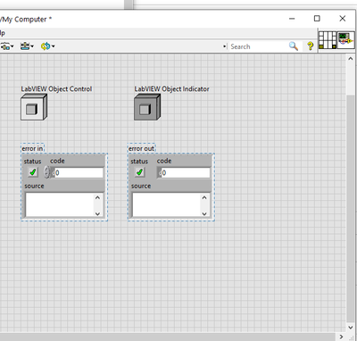

This shortcut menu is very useful for quickly assigning error clusters or class controls from BD or FP to the connector pane. It only works with one of them and the selection is restricted to one indicator and one control.
There is a one caveat that I don't know how to easily solve. How to deal different connector panes? In this case, it is considering the position in the LV default connector pane.
Aside that, I would appreciate any comments or suggestions on the name or how it should appear in the menu.
Before:
After:
