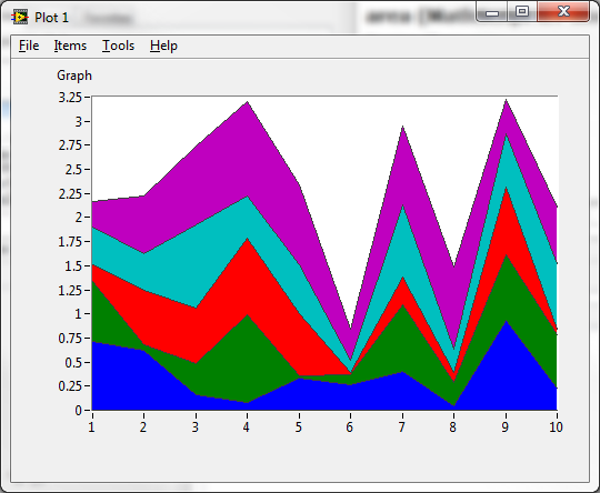

You can create filled-in line graphs using the 'area' function. These are good for trending proportions over time.
