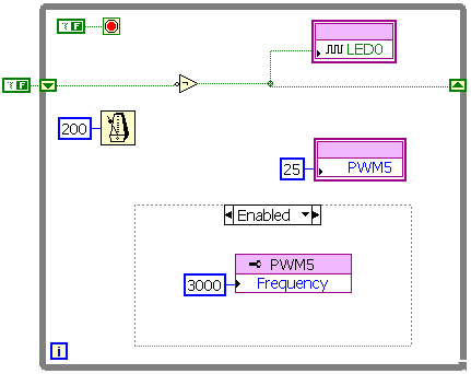

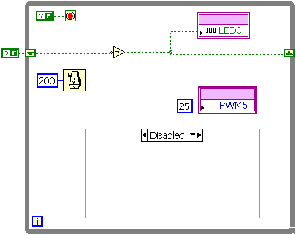

Hi.
A screenshot is worth 1000 words, so:
1) works very nicely ...
2) fails ( FaultISR ) ...
Same compiler/project settings for both cases, of course, the defaults shipped with LV ARM.
What am I missing here?!?!?

More detailed info, from the debugging tools in uVision: the problem is a Bus Fault. BUS_FAULT_ADDR:0x40028040; BUS_FAULT_START:0x82. PRECISERR is checked, and also Hard Faults > FORCED is checked. May be useful info for someone trying to help ...

Hi Paul,
This looks like an issue where you (or rather LabVIEW generated code) are configuring the PWM peripheral before enabling the peripheral.  The target will fault in this case, but the simulator will not.  Because the PWM EIO node initializes and enables the PWM peripheral, if the EIO property node is executed before the EIO node, the target will fault.  Try using a sequence structure to ensure the PWM EIO node executes before the property node.

Thanks vansick!
In what I'd call a highly counter-intuituve fashion, it worked. Flat sequence, 1st start the PWM, 2nd set PWM properties, 3rd infinite loop.
