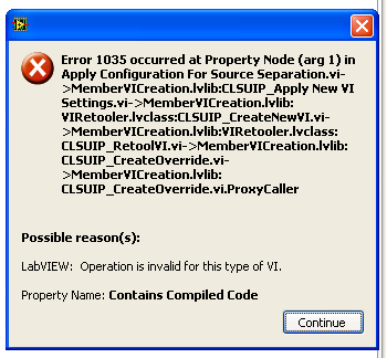

I'm getting an error message when trying to make the overriding VI's for the plugins,
Can someone point me in the right direction to cure this problem?
This is a LabVIEW bug. You'll need to do a workaround to make your Override VI. To do this, create a dynamic dispatch VI in the child class (plug-in), and give it the same name as the VI it will override; make sure the connector panes match.
I'm guessing this is LabVIEW bug, because I don't see any reason why creating an Override VI should require the parent method's code, only it's front panel objects and connector pane. It would be nice if NI would fix this, or at least catch the error and present a dialog stating "Can't auto-generate an Override VI from a method within a packed project library."
I do agree on this, always that you don't try to change your compiled code but you try to create a "wraper" with extra funtionallity, it should be possible.
If I understand the issue correctly from this discussion, this issue occurs, then, because the override template automatically calls the parent method. (I argued a long time ago that this shouldn't be the default behavior. It is simply one of the possible behaviors, and not the one that I use most often.) If this is the case, it may be possible to modify the template (if it is just a simple template) to remove the call to parent method to avoid the error. (I have modified the static template before--to remove the case structure and so on, but I don't recall modifying the dynamic/override template.)
Or maybe I am wrong and you should be able call the parent method even if it doesn't have its block diagram? I guess you should be able to do that, too. Well, it would be an interesting test to do....

If you are encountering LabView crashes when working on uncompiled plugins:
I had a project for the abstract parent plugin, and a separate project for all the children plugins using the lvilbp of the parent. This worked fine for four plugins, but when I created the fifth plugin I got LabView crashes (LV2011) after running test code of the plugins (uncompiled). Compiled code didn't crash, but it was driving me nuts!
Moving the fifth plugin into its own project solved this completely. It wasn't using anything that wasn't already shared between the previous four, it didn't use any dlls. Its only difference was that it used VISA (the rest used dlls). I'm not sure why it caused crashes, but in any case I will have separate projects for each child plugin in the future.
Danielle
