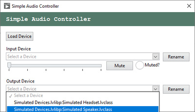

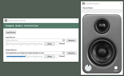

Application Screenshots:
On Launch:
Load the simulated devices PPL:
Select an Output Device:
Adjust the Level/Mute status on either UI - see that the changes are synchronized:
