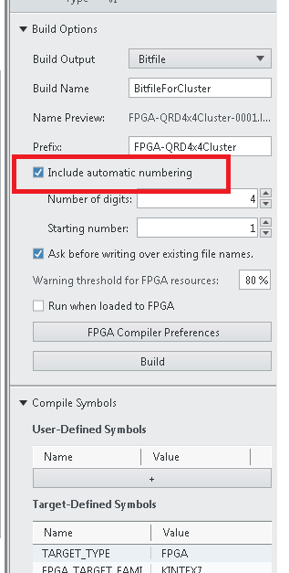

Each compile takes 4 hours on the NI Cloud Compile server. My computer sometimes doesn't like it when I have too many projects open at once, so I'm not sure how many I can actually compile at a time. So it could take all day just to hope that I get a design that works.
In normal Xilinx tools I think you can set optimization goals. Is it possible here to set NI to optimize for timing?

Chance,
You should be able to kick of multiple compiles from a single project when you have automatic numbering set:

Cool. Thanks!
I forgot that I could do that.
