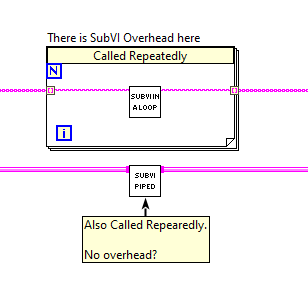

In the screengrab above, if the stream channel endpoints are removed and replaced with array controls and indicators, the example becomes your usual run of the mill dataflow, where each subVI  executes in sequence. In such a scenario, it is clear what happens. Each subVI executes in sequence, once. And with each subVI call, there is an overhead associated with each call, unless the subVI is inlined. And if the subVIs themselves are in a for/while loop and called repeatedly, each iteration of the loop adds some amount of overhead.
My question is: In the above example with channels, each subVI receives the input piecemeal, and all of them run in parallel. But each subVI is now effectively "called" multiple times. So, once the first line of the text is read, it is sent to the next subVI. While it is being processed, the second line is read. Once the Grep Strings subVI finishes processing the first line, it receives the second line of text and runs again, and so on. It seems analogous to the Grep Strings subVI being in a FOR loop and getting called repeatedly. But in the example subVIs, each is set to be a preallocated clone, but not inlined. So would that not add overhead? Or does having channels somehow automatically inline the subVIs?
Basically, my question boils down to:

SubVIs with channel wires as inputs execute in dataflow order, ignoring the channel wires themselves. They are invoked only once when their inputs are available. There's no "multiple call overhead" because there are no multiple calls. No special needs for reentrancy/inlining/etc. Each of the loops inside the subVIs runs in parallel, continuously invoking the endpoint subVIs.
If a subVI with a channel wire is non-reentrant, that means only one copy of the subVI is running at once across many different call sites -- exactly the same meaning as non-reentrant always means. If it is (either type of) reentrant, that means that multiple call sites can proceed in parallel.

Going a bit further -- if you mentally replace the channel wire with array wire, you do not think of the main subVI as being wrapped in a For Loop... instead, you think of the endpoint nodes as being replaced with Index Array and Build Array (respectively).

Actually, no. Pretend the subVIs are labeled 1, 2, 3, 4, 5, and 6. Because they have zero dataflow dependencies, subVIs 3, 4, 5, and 6 start running immediately. SubVI 2 will start running as soon as the string is available. SubVI 1 will start running as soon as the path is available.
SubVIs 3, 4, 5, and 6 will both do whatever initial work is inside of them up until the moment they start waiting on data from the channel wire -- in the case of 3/4/5, that's the endpoint node. Since 6 *is* an endpoint node, it's whatever setup work endpoint nodes do when they're first called.
To put it another way: If you were to put a One Button Alert in subVI 3 outside of both of its While Loops, that alert would appear as soon as you hit run on the main diagram.

Is that what happens with any other non-reentrant subVI that you drop multiple parallel copies of? No. So the answer is still "no" when a channel wire gets involved. Just mentally delete the channel wire and analyze the dataflow dependencies...
Can you picture it? Let's see if you're right... here's the answer:
With 1,2,3,3,3,3, all the 3s start attempting to run at the same time because none have any dataflow dependencies. One of them at random starts running first. When it finishes, the next -- at random -- will start running next. And so on. If it happens that the order chosen is "first 3, second 3, third 3, fourth 3" then the program will run to completion assuming 1 and 2 eventually send a stop signal. But if any other order occurs, the program just hangs filling up one of the channel buffers.
