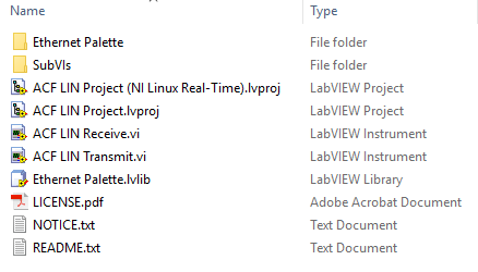

The contents of the ZIP are shown below:
