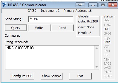

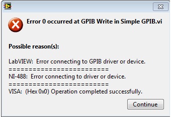

I am Using the NI USB2GPIB-Adaptor and want to communicate with any GPIB-Device by using the Simple GPIB.vi out of the NI-Example VIs.
Starting the VI with the correct GPIB-Adress of the Device occurs in an Error:
My Settings of the GPIB Adaptor are these:
Can anyone explaine, why in MAX the communication runs:
but not in the VI. In the VI I get the Error flag, when I try to use the GPIB write function (Error bit 15 is set to 1).
Can anyone please help me?

I use as a GPIB-Device the "Keithley 487 picoammeter." But the *IDN? should be answered by any device, which is actually not possible.
Please keep in mind, that with the MAX I can send the *IDN? and get a reply (please see third pic in my initial posting).

Here is a screenshot ov the VI. As I wrote in my first posting, you can find it on your Harddrive by searching "Simple GPIB":
If I try to open a VISA-Tespanel, I get this (please see the error message at the bottom of the screenshot.:

In the first picture you've posted I can see that the other two instruments did not answer to the IDN Query by MAX. Did you try to connect the USB-GPIB-HS directly to each one of the instruments? Just to be sure, that the cable isn't causing this problem. Then I'd advise to change the USB-GPIB-HS.
I also noticed, that the answer to the IDN Query is once NDCI-0.00001E-03 and once NDCI-0.00002E-03. Looks more like a measured value than an ID-String to me?
