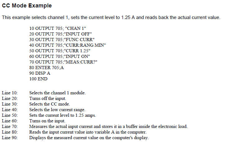

I have figured out the issue.  It is with the driver that is provided.  Apparently, the driver 'tries' to be an all-in-one; but after reading the Agilent's programmers guide for this instrument I found out that there is a difference between the NI IDnet's driver and the programmers guide.
The programmers guide can be downloaded on the Agilent's website.
Using the NI Idnet driver as a base, I modified the appropriate VI (CR/CC/CV config) following the command sequence as suggested by the programmers guide and it seem to work fine.

I have only modified the driver in a way that will allow my application to function properly (i.e. allowing user to select between modes of operations (CR,CV,CC) without error occuring).  The modification is only done on the Config Voltage, Current or Resistance subVI.
I have attached an example of the modification done below.
CC Mode Aglient Programming example
Config Current
As you can see, I basically remove those 'call functions' that does not concern me and only include those commands that are used.  Almost replicating what I would do with the actual 3300 front panel controls.
