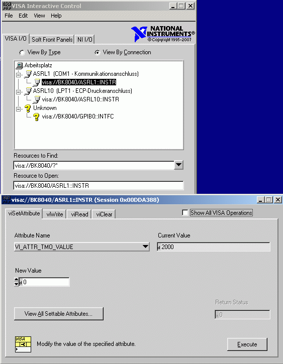

Workbench PC's MAX > NI-VISA > VISA Interactive Control:

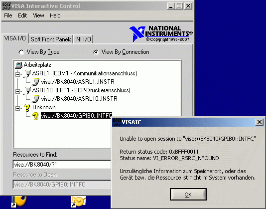

A double klick on item "visa://BK8040/GPIB0::INTFC" (item shows yellow question mark) leads to the following message:
| VISAIC
| Unable to open session to "visa://BK8040/GPIB0::INTFC"
| Return status code: 0xBFFF0011
| Status name: VI_ERROR_RSRC_NFOUND
However a double click on item "visa://BK8040/ASLR1::INSTR" opens a dialog box with the setup of the testbench PC's COM1 interface, so the VISA connectivity between workbench PC and the testbench PC's COM1 interface works fine.

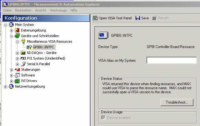

At testbench PC's MAX > NI-VISA > VISA Interactive Control:
A double click on the suspicious VISA Resource "GPIB0::INTFC" (here also a yellow question mark) shows
| Device Status
| VISA returned this device when finding resources, and MAX
| could use VISA to parse the resource name. MAX could not
| successfully open a VISA session to the device.
Indeed the testbench PC can use his VISA Instrument descriptor
TCPIP::192.168.178.1::hpib0,23::INSTR
even without a MAX-Configuration of the gateway, but the gateway is not accessible from the workbench PC.

Hi Martin,
it is not possible to use the Agilent Gateway through remote VISA. Reason for that is that the Agilent gateway is not recognized as a GPIB device on the testbench's MAX. Hence it is not possible to use it via remote VISA.
You have three options to use your Voltmeter from the workbench PC:
1.  You can purchase an NI GPIB product that he can use to connect to the Voltmeter. This will be recognized properly by MAX, and thus able to be remotely accessed on the second machine.
2.  You said this is not possible, but you would need to put the cards on the same subnet, or have some kind of routing between then.  Then you would be able to access the resource on the workbench machine by using a TCP/IP resource name
3.  Lastly, you can try using Agilent VISA (ensure he has this installed on both machines).  You should be able to recognize the E2050A as a GPIB resource, and then access this remotely.
(Thanks to Kelly for the help!)
