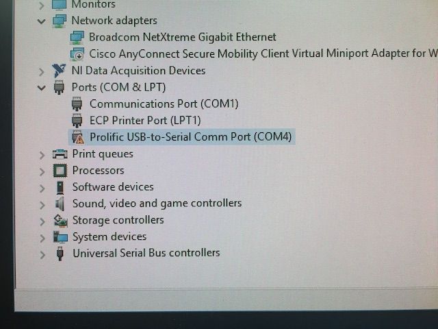

I attached picture of result.
When I connected usb cable to pc. pc recognized this equipment as COM4. However, it is not worked properly. and even in ni-max and visa interactive control, it cannot recognize anything in com4.
I also installed Keithley configuration panel and it also cannot recognize the equipment. so I tried to add the equipment to COM4, but it answered there is no hardware on that port(COM4)
and I updated and reinstalled the driver on device manager on window.
But is is also had same result.
Now What can I do for this equipment?
I am totally confused what is the next step for setting this equipment.
NI-MAXNI-MAXVISA Interactive controlVISA Interactive controlWindow device managerWindow device manager

Device manager shows an exclamation point next to COM4.
MAX is not showing COM4 either.
You may want to try to resolve the COM issue first.
-AK2DM

You're right only the newer 2450 or 2600 give you the option to use a language other than SCPI (SCPI, SICL or TSP), so if you have set it to RS232 that's not the problem.
Looking at your photos it looks like you might not have the driver for the Prolific USB-Serial connection setup correctly.  Did you install the driver for it?  How do you know there's anything on COM4?  Nothing listed in NI-MAX showing COM4.
Craig
Message 8 of 18
(11,449 Views)
I deleted the driver for usb and reinstalled the driver for usb.
and also when I plugged out the Keithley 2400 usb in the pc. COM4 connection is disappeared. and when I plugged in the Keithley 2400 usb in the pc, COM4 connection is appeared. this is the reason why I think Keithley 2400 is using COM4 port.
