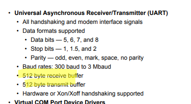

You’re conflating things here. The VISA buffer of 400000 bytes that you allocate has nothing with the hardware buffer overflow to do. The hardware buffer is in, yes hardware in the form of a FIFO and can not be enlarged by you. Not even VISA has any direct control of that. The serial port is handled by the Windows serenum driver which is called by the Windows COMM subsystem. VISA then accesses the Windows COMM API. The error you see is the serenum (or hardware specific) device driver not being able to service the serial port interrupt before that FIFO is full?
in terms of data you seem to receive about 9950 bytes per 200 ms, so 49700 bytes per second, or around 500000 Baud. FIFO buffers are relatively small sometimes as little as 16 bytes but very seldom more than 256 unless you have special high speed serial port controllers. This means that the device driver needs to be able to react within 0,2 ms to at most 2 ms. That’s though under Windows! You may need a more capable special serial port interface card with its own device drivers, to be able to operate at this speed continously.

Looks like the datasheet has more info,
Mfr recommends using dll instead of VCOM for special applications.

Perhaps I'm not explaining myself well. I tried to mention that I was trying to figure out WHICH buffer overflowed in my original post. I really appreciate your posts, and I know you know WAY more about this than I do, so I'm really trying to learn. The bolded part of your message is what I'd originally assumed the error was, however, the whole thread until now has been talking about ways to make sure the VISA buffer doesn't overflow. I'm not certain, but I would guess that keeping the VISA buffer emptied has very little, if anything, to do with the hardware buffer.
I fully understand that there are multiple buffers, interfaces, etc. in play when going from the actual serial layer to USB to DLL to Windows to VISA to RAM to LabVIEW etc.
Me posting the info above is my attempt to address the first few comments regarding array resizing, producer/consumer, etc.
Going back to my original question- is there any way to view the ACTUAL error. The LabVIEW error code -1073807252 just says "VISA Overrun" with no further details. I have no way of knowing (due to my limited understanding of the underlying implementation) where in the giant chain of buffers this error is getting thrown.
LabVIEW Help (for example) again just says things like "reduce the data" or "switch to producer consumer", not "make sure your hardware is fast enough".
Anyway, I don't think this is a VISA problem, but a hardware one, and it's why I posted this in the first place. I have several things that I think could be a problem; is it the USB port getting overloaded? Do I need to switch to a chip with a larger buffer? There seems to be a 16-byte FIFO somewhere in the chain; is that one getting overloaded? Is it the buffer on the chip itself?
Basically I'm just trying to find where the actual error is. It sounds like you're telling me it's the actual on-chip buffer overflowing, which is understandable, and isn't something I can fix directly. I'll definitely investigate things further.
ALL THAT SAID.... I may have found two partial problems. The first was that it seems I had a pending Windows update, which on Windows 11 tends to make basically everything worse. Second, out of desperation I threw an oscilloscope on the Tx/Rx pins to see if the chip was simply going bad. It seems that adding the oscilloscope ground seemed to help, as I was able to start getting 10 minute streams of data with no dropped packets or overflow errors. Perhaps I was getting extra bits in there somewhere from electrical issues or a damaged chip? Who knows.
I'd still like to be able to get more error info, as what you said ("The error  you see [...] is the hardware specific device driver not being able to service the serial port") is INCREDIBLY valuable info that I wasn't able to find anywhere else, so I really appreciate that info. If that's listed in the LabVIEW Help somewhere I'd really love a link, as I couldn't find it 😞
