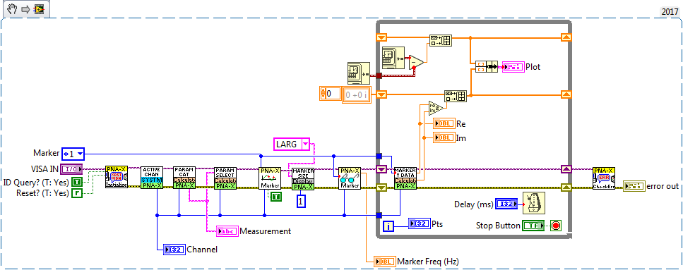

I don't have any experience with the E5061B, but have a lot with the N5245a which uses similar commands.  Here's how I monitor a single cursor vs. time.  (Note that you need to do your cal, save the setup, then run the program without reseting the instrument to default values.)  You can extend this example to monitor multiple cursors.
Post your code here for further help.
Craig
